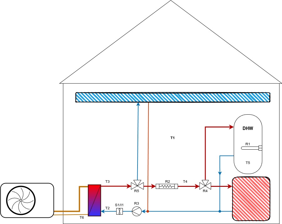

Schema
Hydraulic connection diagram

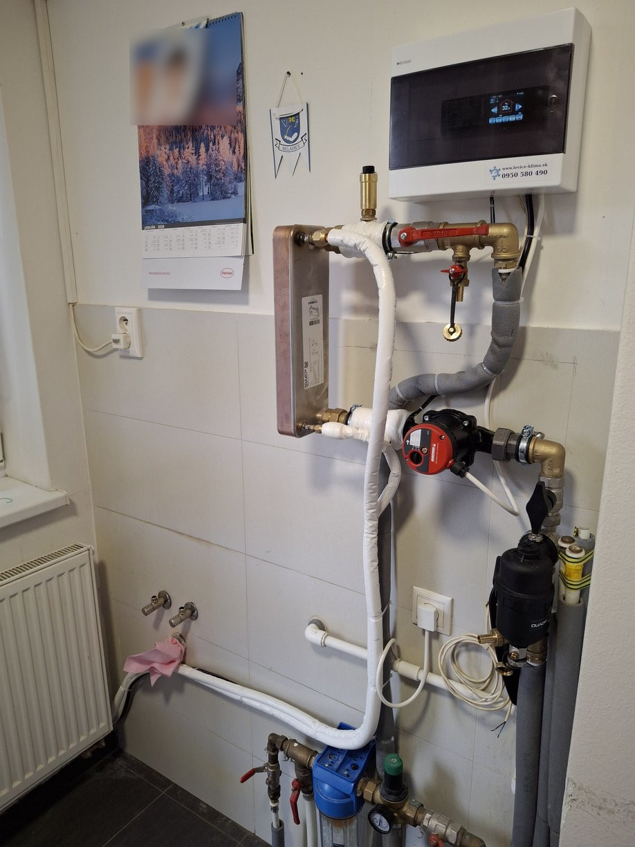

Installation
Compact Installation
MiniHPC is designed for a standard DIN rail (9 modules). All inputs and outputs are clearly arranged for easy and safe installation in the distribution box.
