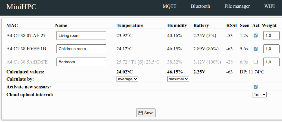

Multiple sensors in the household
MiniHPC can read data from up to 10 supported temperature sensors simultaneously. From the measured temperature and humidity values, it calculates the average temperature and humidity (or minimum/maximum, depending on the setting). This calculated temperature will then replace the T1 temperature sensor.
The list of available sensors with their measured values can be accessed by opening the device’s IP address in the Bluetooth menu.
Bluetooth web
In this section of the MiniHPC configuration, it is possible to enable/disable individual sensors, change the name and assign them weight values for the average calculation. For example, for a temperature sensor located in a larger room, you can assign a higher weight, so its reading will have greater influence on the average. If a sensor is disabled, its value will still be displayed in the table but will not be included in the calculation.
A sensor that has been stored in the database but has not sent data for more than 60 minutes is considered lost and can be deleted from the database by clicking the trash icon on the right side of the table.
At line Calculate by:, you can set whether the calculation should be based on the average, or whether the maximum/minimum measured temperature should be used. This can be configured separately for temperature and humidity.
The option Activate new sensors defines whether newly discovered sensors will be activated automatically (ideal if they are used only for MiniHPC), or whether they need to be activated manually. Manual activation is useful in cases where the user has more BTHome v2 temperature sensors in the household and does not want newly added ones to be automatically included in the MiniHPC temperature/humidity calculation.
Cloud upload interval: Sets how often Bluetooth data are uploaded to On-line cloud. One MiniHPC has space for approximately 5000 Bluetooth records on the Cloud portal. One thermometer with a 1-minute upload interval generates 1440 records per day, so older data will be overwritten after about 3 days. If 3 thermometers are connected to MiniHPC, they will exhaust the 5000 record limit in about 28 hours at a 1-minute upload interval. Therefore, if uploading data every minute is not necessary (for example for diagnostic purposes), we recommend increasing this interval to 5 minutes or more.
When modifying Bluetooth settings, we will be prompted to enter a username and password, which are listed in the menu 9.2 WiFi AP

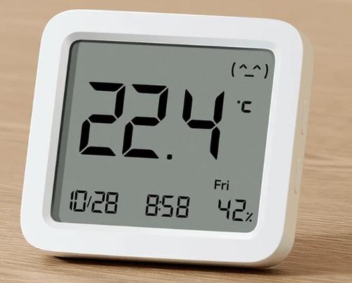

Xiaomi MJWSD05MMC as a Thermostat
Xiaomi MJWSD05MMC
Xiaomi MJWSD05MMC (Xiaomi Smart Temperature and Humidity Monitor 3) has two buttons on its right side. In the standard ATC firmware, these buttons are used to switch screens and enable Bluetooth communication.
The modified ATC firmware BTE_v56_thermostat.bin changes the function of these buttons and also modifies the information displayed on the screens. It adds a new function that allows the desired temperature to be set directly on the thermometer. This value is then transmitted to MiniHPC using the BThome v2 protocol.
Button functions in the modified ATC firmware:
  • The up/down buttons adjust the set temperature with a short press. The adjustment resolution can be configured on the third screen.
  • A long press of the upper button switches between screens.
  • A long press of the lower button activates the option to immediately connect to the thermometer via Bluetooth.
Screen description:
  • Screen 1 displays the set temperature as the main value. The bottom row shows the date, measured temperature, and measured air humidity.
  • Screen 2 displays the measured temperature as the main value. The bottom row shows the date, set temperature, and measured relative humidity.
  • Screen 3 displays the configured resolution (how many °C the set temperature changes when the buttons are pressed), with the option to adjust this resolution. The bottom row shows the date, battery voltage in V or mV (when below 3000 mV), and battery level in percent.
Xiaomi MJWSD05MMC - 1 Xiaomi MJWSD05MMC - 2 Xiaomi MJWSD05MMC - 3
The temperature set on the thermometer is periodically transmitted to MiniHPC using the BThome v2 protocol. In the web interface, this set temperature can be displayed and its parameters can also be adjusted.
